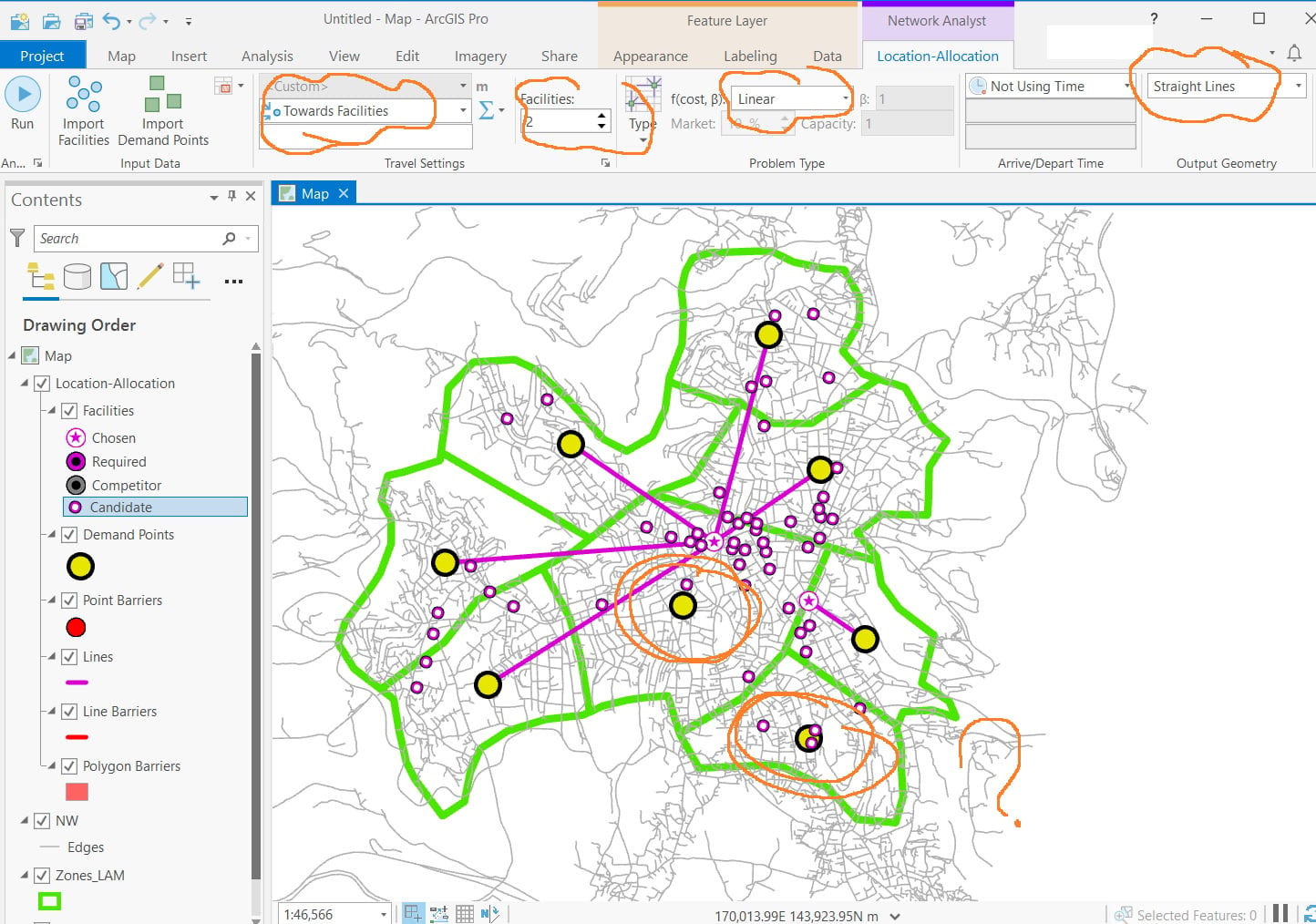

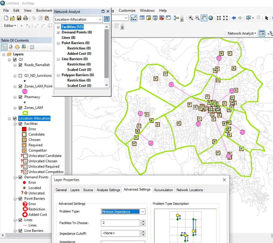

Despite the fact that running “Location-Allocation” model in ArcMap manages to allocate potential destination for each demand point, Pro leaves two of these demands with no such potential destination knowing that all the assumptions are identical in both ArcMap and Pro
What could be the issue here?

Is there some snapping tolerance which is different? e.g snap to nearest network edge / maximum distance etc/
JaySandhu
It could be few different reasons. The first is that the settings are not identical. They appear to be. But most likely the network dataset settings such as restrictions could be different. Pro works with a travel mode (custom in your case) and ArcMap works on some defaults if they are set. So check these settings in Pro. Another is that Pro has a slightly different snapping model. So the locations could be snapped to a different edge if there are restrictions present in that area. You could open the attribute table of the demand points and look at the network location fields (e.g. SourceOID) and see if they are the same between ArcMap and Pro, assuming you are using the same network dataset.
