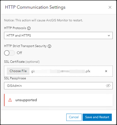

What Type of SSL File needs to be Uploaded in ArcGIS Monitor 2023.2
565
11-15-2023 02:42 PM
BHK
Trying to install and configure ArcGIS Monitor 2023.2, I am facing with unsupported error message when uploading our certificate file in .pfx  format
Can you please let me know why this is happenig and what is the proper format for uploading SSL into ArcGIS Monitor?
GeoJosh
Hello,
This error message typically indicates that the certificate is using a weak algorithm. You can read more about this issue in the technical article below:
https://support.esri.com/en-us/knowledge-base/problem-openssl-3-x-changes-and-legacy-provider-deprec...
Josh
