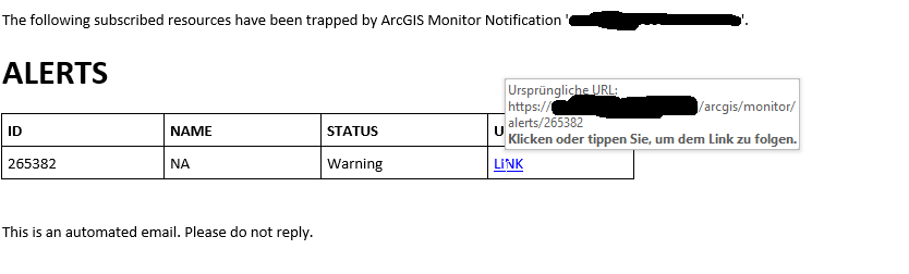

We have recently upgraded to ArcGIS Monitor 2023.3. Since then, the url link in the email notifications does not seem to work anymore.
These links in the email point to https://myserver.com/arcgis/monitor/alerts/<alert number>
When opening this link, ArcGIS Monitor automatically forwards to https://myserver.com/arcgis/monitor/alerts/<alert number>/overview

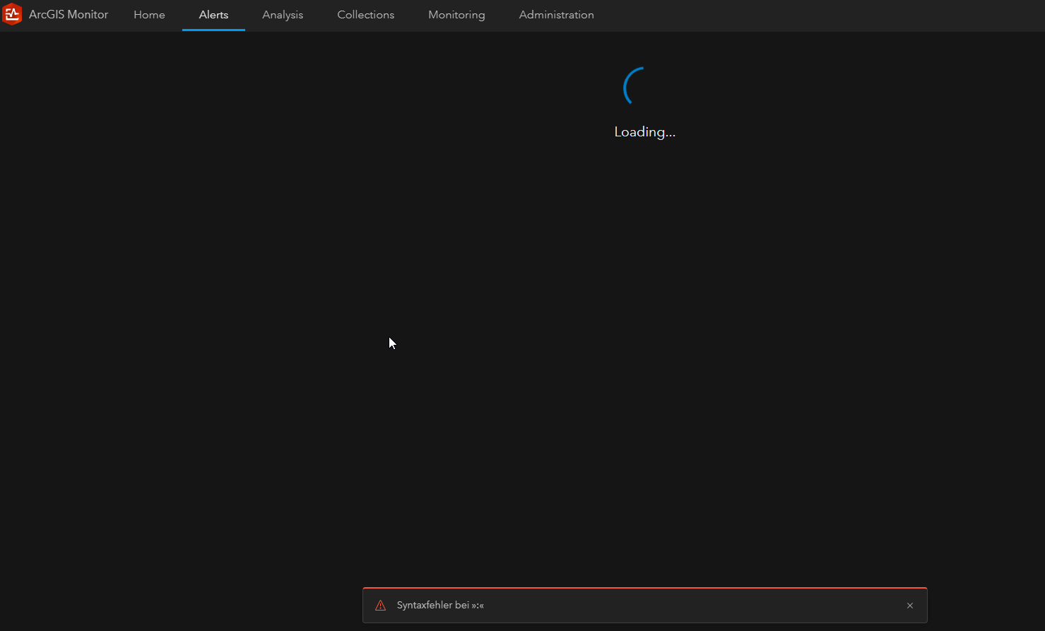

This is no longer working in 2023.3. The forward leads now to https://myserver.com/arcgis/monitor/alerts/:alertid/overview - resulting in an error.
Is this a already known bug that may be fixed in the 2023.3.1 patch?

Hi @Tobias_Gerber ,
This will be address in the 2023.3.1 patch due to release at the end of the month.
