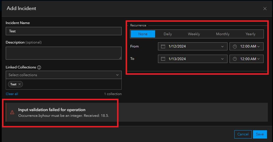

We are trying to create an incident with custom recurrence in ArcGIS Monitor 2023.3,  But we are getting errors: " Input validation failed for operation. Occurrence. byhour must be an integer. Received: 18.5". And attached are the screenshots for the reference

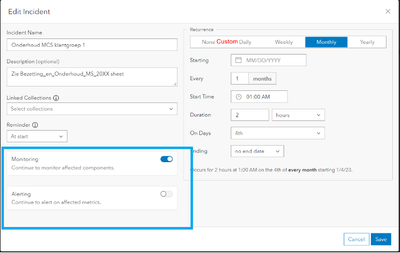

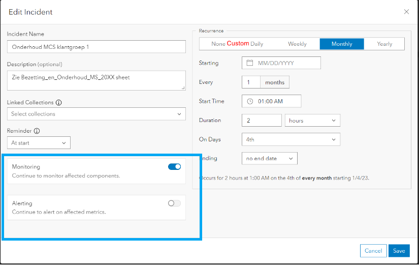

Additionally we are not getting these two options (attached) in ArcGIS Monitor 2023.3 while comparing it with ArcGIS Monitor 2023.2. Attached are the screenshot for the reference:

The error in your first screenshot is a bug having to do with working in browsers whose timezones are ahead of UTC time by a half hour interval. For example, India Standard Time is 5.5 hours ahead of UTC. I have reproduced and logged this as a defect in the dev team's backlog.
To answer your second question, Incidents in Monitor 2023.3 automatically suppresses Monitoring and Alerting which makes the toggles irrelevant. Do you have a use case where you would like to define an Incident and still collect metrics data and/or alert on?
