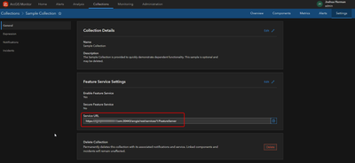

Hi @JaimeSF_EsriSpain,
In Monitor we see all the metrics records, but if we create a Collection, we only see the metrics from the previous day without setting any date
When you say "Collection", are you referring to the Collections Overview page (below)..
Or are you referring to querying the data through a collection feature service?
Josh
JaimeSF_EsriSpain
Hi Josh,
Im referring trought a collection feature service. I configure the expression to select a specific label, metrics such as requests received, requests failed, etc. and that they were created in the last 7 days.
Thanks!
Jaime
