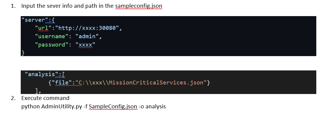

Using ArcGIS Monitor 2023.2, I have downloaded the  AdminUtlity from Here
and the ArcGIS Monitor 2023.2 sample gallery (Analysis sample: Mission Critical services) from Here
I have updated the the server node
    "server":{
        "url":"https://gmonitor:30443/",
        "username": "ADMINUzer",
        "password": "PASS0rd"
and the analysis
    "analysis":[
            {"file":"C:\\Monitor\\MissionCriticalServices.json"}
But when I run the script by CMD, I am getting these errors!
python AdminUtility.py -f SampleConfig.json -o analysis

Can someone please tell why this is happening. Should I fill all nodes of the the sampleConfig.json? basically what I did was just  updating those to nodes as the document mentioned in section 4 of the MC_Services.docx
IrisHadarStltd
Hi ,
Try to use the AdminUtility.exe , for us it  functioned seamlessly.
this is the JSON we used.
    "server":{
        "url":"XXXX:30080",
        "username": "xxx",
        "password": "xxx"
    "password_encoding": false,
    "analysis":[
            {"file":"C:\\ArcGISMonitorAddOns\\MissionCriticalAnalysis\\Test22.json"}
