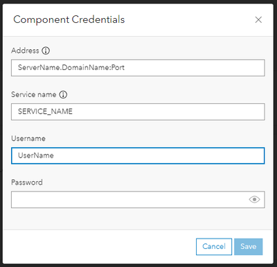

IrisHadarStltd
Yes ,
We also managed to connect to an Oracle database .Attached Screenshot of the data we entered.
I think it's worth checking  from the monitor machine itself:
1. Is it possible to make a connection using SQLPLUS to the DB
2. TNSPING works properly
