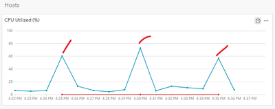

Hello! I just had the pleasure of debugging this oddity in our server.
This happens because of the scheduled observers. The observer that grabs the system metrics is "Metrics - Host Windows". This (for us) is scheduled to occur every 1 minute. Other observers were also scheduled to occur every 1 minute.
In other words, the CPU Utilization is the exact CPU Usage % of when the "Metrics - Host Windows" observer runs. Since other observers run at this exact same time, it causes a brief CPU spike.
If you measure the CPU Spike from Performance Monitor, it exactly matches what Monitor Displays.
Setting "Metrics - Host Windows" to check every 1 minute, and others at other times, creates a much more accurate chart. An example is below.
In below example, system metrics are recorded every 1 minute while all other observers run every 5 minutes. You can see the dramatic spike that happens every 5 minutes.
To be honest, it's a pretty serious configuration flaw with observer scheduling. ESRI should include an option to where we can stagger the observer run times. Example, start running at "00:00:30" with a repeat interval of 1 minute. This would perfectly fix this problem!
Please vote for this idea here!!! https://community.esri.com/t5/arcgis-monitor-ideas/add-start-time-setting-for-observers/idi-p/171287...
