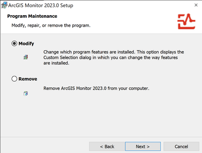

If one component is installed running the installer will detect the installation and offer you to Modify or remove the installation:

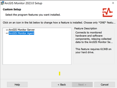

When you go to Modify, the option for the Agent is visible, but it is only possible to select one feature:
