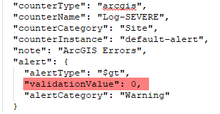

I'd like to change the validation values of the default ArcGIS Alerts. It would be easy enough to modify the cpj file. Is this supported?
Tags (1)
PhilLarkin1
I gave this a try. Didn't crash the application. Time will tell if it continues to monitor properly. Config files are located here: <install location>\ArcGIS Monitor\Administrator\resources\app\collector\defs
