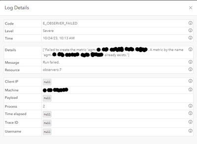

MarieCline_Delgado
Hi @GeoJosh .  Can you help me understand how to fix my Discover Observer?  The observer has an error and the log details state ["Failed to create the metric 'agm-machine-name.domain'. A metric by the name 'agm-machine-name.domain' already exists."]
Thanks for any advice!
MarieCline_Delgado_0-1698160823136.pngMarieCline_Delgado_0-1698160823136.pngMarieCline_Delgado_1-1698160861131.pngMarieCline_Delgado_1-1698160861131.png
