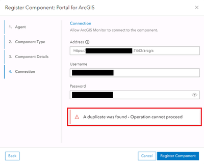

We have 2 Portal for ArcGIS instances on HA.
Successfully registered the first instance with ArcGIS Monitor (version 2023.2) as a Component. While registering the second instance, below error was encountered. How to handle this? Need your help please.
