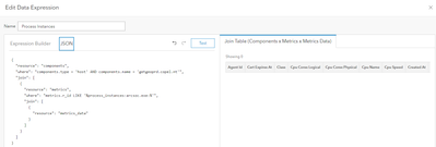

This can be accomplished by targeting the host component, joining all metrics that contain "process_instances:arcsoc.exe:", and then joining the metrics data. Here's my expression:
  "resource": "components",
  "where": "components.type = 'host' AND components.name = '<name>'",
  "join": [
      "resource": "metrics",
      "where": "metrics.r_id LIKE '%process_instances:arcsoc.exe:%'",
      "join": [
          "resource": "metrics_data"

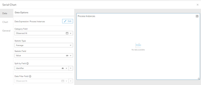

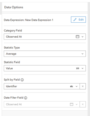

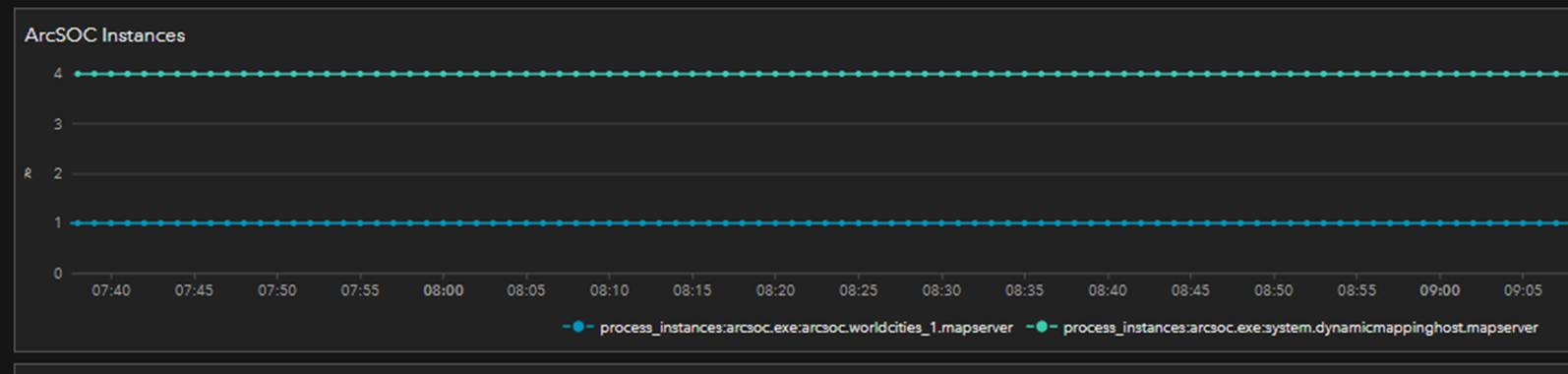

Then, configure your chart like so:

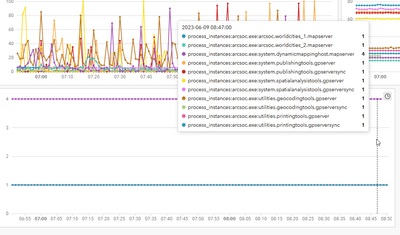

And the result will be a chart that shows number of arcsox.exe process per service over time.

Hi @GeoJosh ,
Thanks for your help
I tried your setup, but now i do not have any record.
Is there any configuration or verification that we can do, because with this configuration it does not return any records.

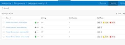

  • If you navigate to the component overview page for the host component you are targeting and click on the Metrics tab, do you see metrics that match the pattern you have defined? ("process_instances:arcsoc.exe")

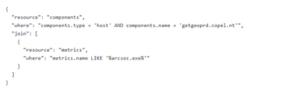

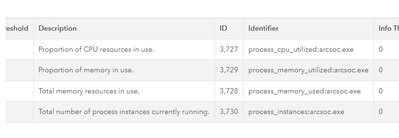

If I keep the join only withs  metrics with name like arcsoc.exe, I have 4 metrics
Navigating on host component, I have only 4 arcsoc pattern to arcsoc,exe
Is it something wrong in that part?
Edna
AndrewSakowicz
@EdnaKanazawa I believe this might be related to windows service  ArcGIS Monitor Server (or agent) user permissions.  To parse process commend line, this use needs to be part of admin group and your original expression should work. @GeoJosh

AndrewSakowicz
Did you register this host using inherit credentials or provided user name/password?  Whatever method you used, this user needs to be a member of admin group machine.  Re doc, we'll update documentation to clarify that in order to see process command line, a user needs to be member of admin group https://learn.microsoft.com/en-us/powershell/scripting/samples/decode-powershell-command-from-a-runn...
