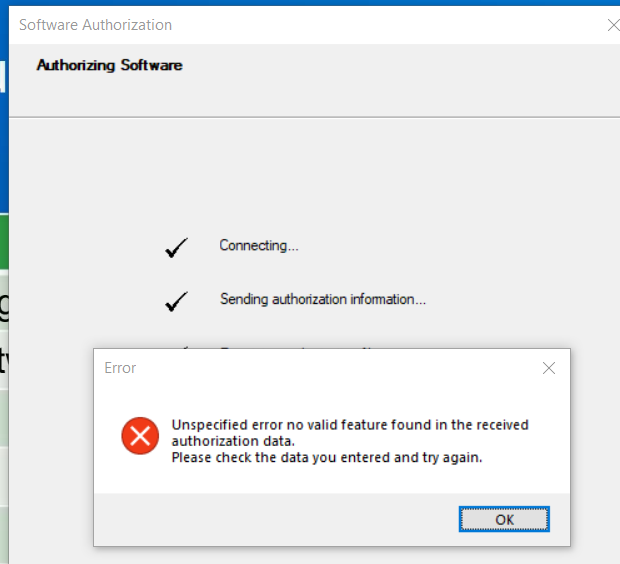

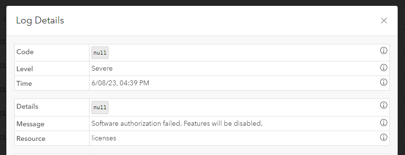

I  tried to license but I do not manage. Both the provisioning file and the simple EPC number do not work.

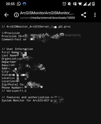

Hi @DerekLaw thanks for your reply.
This is the file.
Everything seems to be in order except for that mismatch on the version.
Could you please confirm that a licence 11.1 is needed for the 2023.1 in order to collect data?
Thanks
