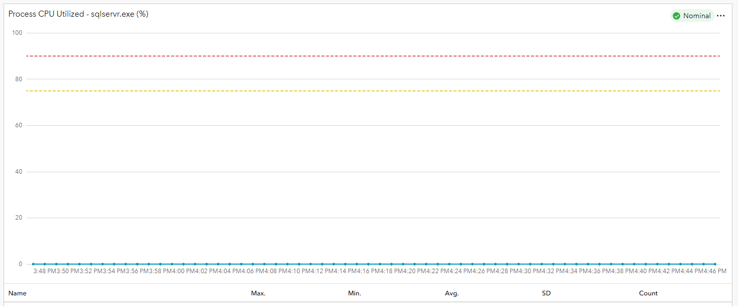

I just added a host component to ArcGIS Monitor and the sqlserver.exe metrics are incorrect. It's showing 0.0 CPU utilized, memory used, and memory utilization:
Task Manager on that server shows sqlserver.exe CPU ranging from 0.5% - 20% for the last hour and memory used at around 9K MB.

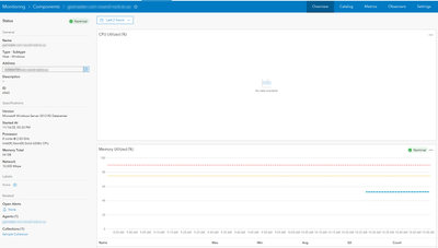

You can see here that it records Memory Utilized no problem, but not CPU:

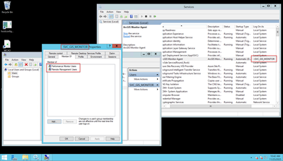

Hi @StevenBeothy, thanks for the helpful reply. I can confirm that I have added the service account to the Performance Monitor Users and Remote Management Users groups:
I also made sure I added the account which I used to register the component to those same groups:

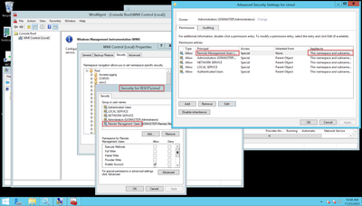

For extra measure, I also enabled permissions for WMI cimv2 (even though I'm at 2025.01):
Needless to say, I have restarted the ArcGIS Monitor Agent and Windows Remote Management services multiple times but I still can't get CPU metrics to appear:
