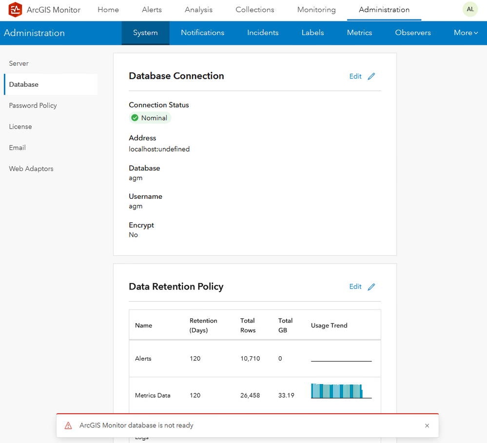

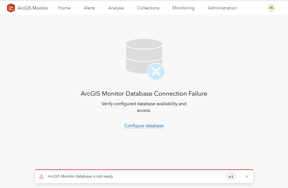

AlexLeonovDataPlusInt
I have similar error after upgrade from 2024.0 to 2025.0.1
After choosing configure database - a long process took place and after its end everything looks fine
But error appears again "ArcGIS Monitor database is not ready" and it was going in circles
For me worked solution to update DB connection - to re-specify the port
