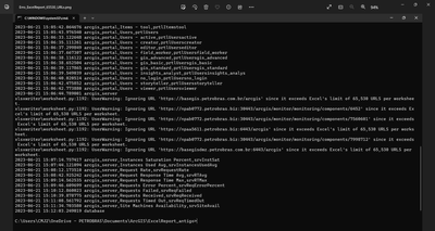

Hi Andrew, I got a new error using ExcelReport. According Excel's documentation, there is a limit of 65530 hyperlinks per worksheet:
https://support.microsoft.com/en-gb/office/excel-specifications-and-limits-1672b34d-7043-467e-8e27-2...
Here's a print of the screen with the error:
What do you suggest to fix it?
Thanks
AndrewSakowicz
@Fabio_Pires  this warning should not prevent generating a report.  Please confirm the report is OK
Fabio_Pires
Hi Andrew, that's correct, the report has been generated even the Excel limitation.
But my question is, it's gonna be a problem to link metrics??
Anyways, I will test to generate each report separate by type: 1 from host, 1 from storage, 1 from arcgis_server and on.
