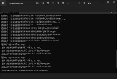

I get this error when I execute ExcelReport for ArcGIS Monitor:
Someone can help me to understand and fix this error? (I would like to keep service in my ConfigSample.json)

@Fabio_Pires , I included this extra check in the latest.  Please download from https://prof-services.maps.arcgis.com/home/item.html?id=248e22510a454e9c906204d3ad45adca
I'm interested to see the service name that has this problem.
Please let me know if you see this print in the command line: Warning during address.split("/") xxxxxx

@Fabio_Pires , please confirm if this fixed the issue above

Note, installing python is not required if you use ExcelReport.exe (it has all of it compiled in) from the dist folder
