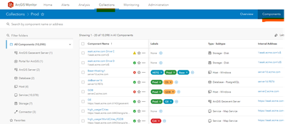

The error message states the Excel report is not able to list components in ArcGIS Monitor for "testing" collection.  Please validate that "testing" collection components are listed using UI: Collections>Components and share the screenshot

   Thanks, I was not linking this to the collections tab in Monitor. I thought it was just the name I wanted to call the collection. That fixed the error and I was able to run the report.
