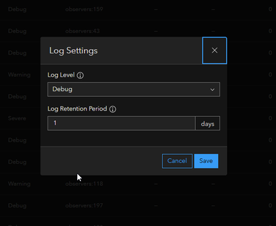

The logs table should automatically get truncated when you change the log retention period in Administration > Logs > Log Settings.
If this not the case for you, there's a chance that a majority of the logs that make up the 1GB were created less than 60 days ago. If you sort the existing logs by date (oldest to newest), do you see entries that are greater than 60 days old?
