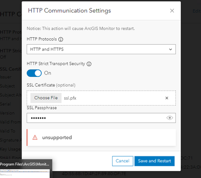

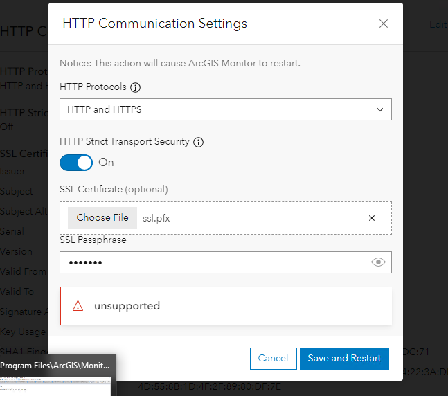

I set up the latest version of ArcGIS Monitor 2023. For security reasons we need encrypted communication in the network...
Under Administration -> Server I've tried to replace the existing certificate with an existing CA-certifcate in pfx-format. It's not working - See attachment. Can you help me?
It seems strange to me why a passphrase is needed. Right, the pfx certificate is password-protected...

To confirm, are you using ArcGIS Monitor 2023.1 and not the 2023.0 release? We fixed a few CA cert bugs at the 2023.1 release. If you are using the 2023.1 release, this might be a new issue - can you please open an incident with Esri tech support so they can investigate further?

We experiencing the same with 2023.2 unfortunately.

thanks for the fast response - Yes, it's version 2023.1. So I'll contact Tech Support.

i am getting same error.  how do i find out if i have missing certificate chain in the prx?
MGunes
i installed 2023.2.0 version and getting same error, waiting for a solution.

Hello All,
this is actually not ArcGIS Monitor issue, RC2 is disabled by default in Node.js 17.
you need to re-create or re-export the certificate and disable pbeWithSHA1And40BitRC2-CBC
you can use keystore explorer to do this or follow the instruction here https://github.com/nodejs/node/issues/40672
