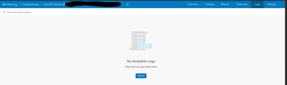

Yes, under Monitoring > Components > Selected Component > Logs Pasted image 20250703155926.png

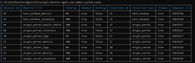

I also tried checking that the logs observer was enabled on the agent.
