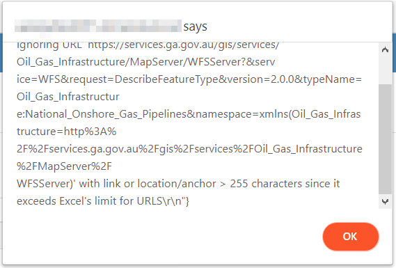

I've found a bug in the System Log Parser for IIS Add-on in ArcGIS Monitor. When http://services.ga.gov.au/gis/services/Oil_Gas_Infrastructure/MapServer/WFSServer is added as an item in Portal and used in a web map, the HTTP requests made to the WFS are longer than 255 characters, e.g.:
https://services.ga.gov.au/gis/services/Oil_Gas_Infrastructure/MapServer/WFSServer?&service=WFS&request=DescribeFeatureType&version=2.0.0&typeName=Oil_Gas_Infrastructure:National_Onshore_Gas_Pipelines&namespace=xmlns(Oil_Gas_Infrastructure=http%3A%2F%2Fservices.ga.gov.au%2Fgis%2Fservices%2FOil_Gas_Infrastructure%2FMapServer%2FWFSServer)
Once this URL is written to the IIS logs being monitored by the System Log Parser add-on, all "Excel" reports generated by ArcGIS Monitor for the time period for which that URL exists in the logs, will fail:
This is because the URL is too large to fit in an Excel cell. The workaround is disable the add-on in ArcGIS Monitor Administrator while creating the report, then re-enabling the add-on afterwards (this does mean you miss having any of the add-on specific metrics in the report).
If the add-on is revised in the future, can URLs over 255 characters long in the IIS logs be truncated so they can be## written to the Excel report?
