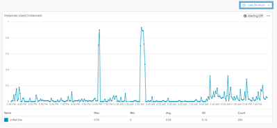

Please confirm using metrics UI that Instanced Used for arcgis server and selected services are not 0 for that time, share screenshot e.g.

Here is the Instances Used chart for one of the sites:

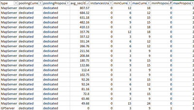

I just re-ran a report to make sure I was capturing the same 24hr period reflected in the chart and was still getting all 0 values. I did notice that the min/maxProposed are 1/3 for Geocoding services, but Map Services are 0/2.
For my other site it's the GP service that's 1/3 while my Map services are 0/2:
Thanks again.
