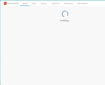

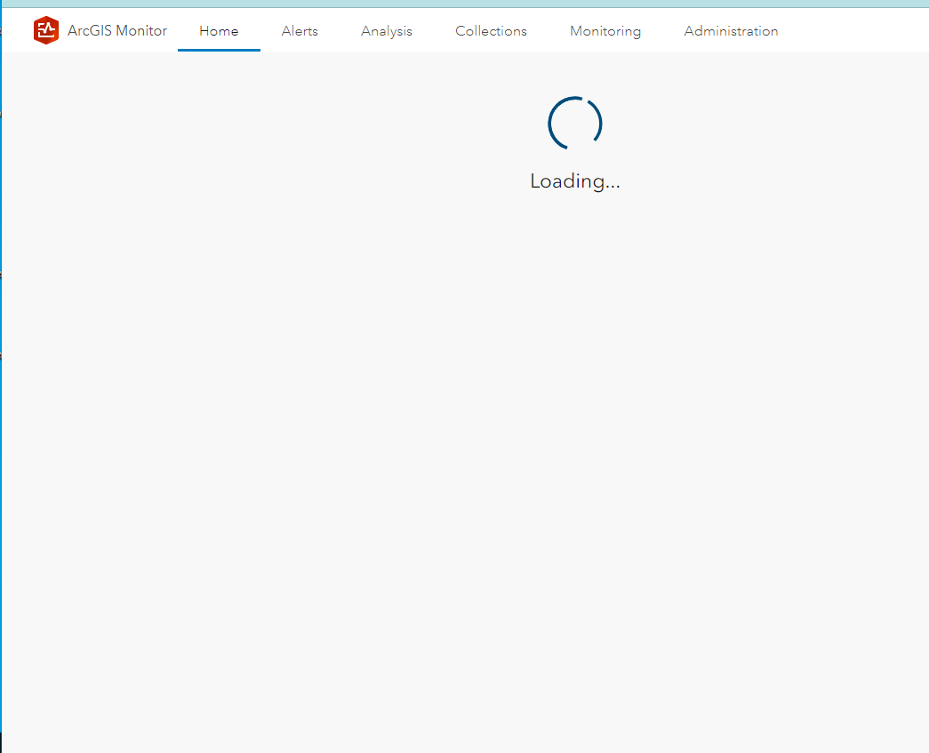

While trying to create analysis views, ArcGIS Monitor has become unresponsive and is stuck "loading", eventually returning "Error Knex: Timeout acquiring a connection. The pool is probably full. Are you missing a .transacting(trx) call?"
I restarted the Monitor and Postgres services and was momentarily able to get into ArcGIS Monitor before the behavior returned.
Any ideas what the cause and solution might be?
