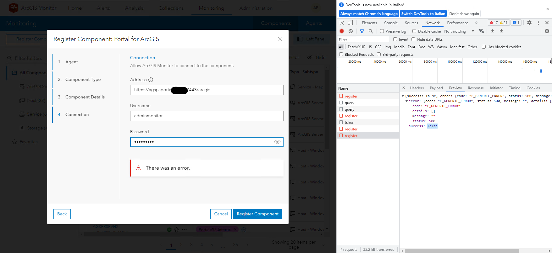

I'm setting up an ArcGIS Monitor 2023 on an ArcGIS Enterprise installation in HA.
all components have been successfully registered except Portal for ArcGIS.
when I register, the Monitor only warns me of a problem without specifying anything else.
I also opened a Browser with the user running the ArcGIS Monitor service to check if it successfully reached the Portal correctly.
I tried to register both through WebAdaptor and through port 7443 but without success.
i managed to catch the error via the Browser with specified token error.
below is a screen
Thank you

Hi Virgilio,
Thank you for taking the time to report this. This error is a known issue and a fix will be included in an upcoming ArcGIS Monitor patch.

Hi @TariqAlOtaibi and @TimSwalin,
The ArcGIS Monitor 2023.1 minor release (which will contain the bug fix) is scheduled for release at the end of April/early May timeframe.

ArcGIS Monitor 2023.1 contains the fix, see the release notes. We won't be releasing specific patches, just software releases. FYI - ArcGIS Monitor 2023.1 release blog.
You can upgrade to ArcGIS Monitor 2023.1 in place.
