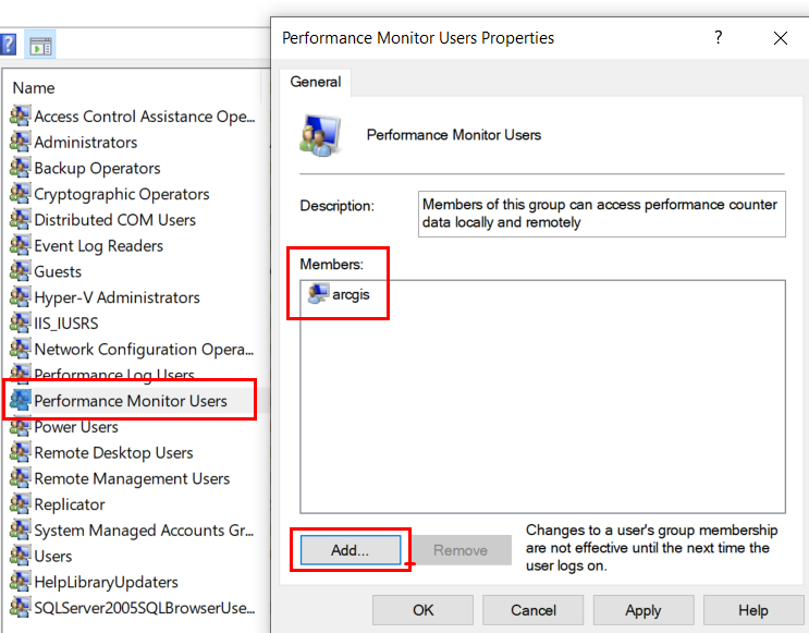

The single most important step is to add the user account that you used to install the ArcGIS Monitor Agent to the Performance Monitor Users groups.
Click the windows start menu and type in lusrmgr.msc to open the Local Users and Groups > Groups > Performance Monitor Users and add in the domain account you used to install the monitor agent.
(My example below is using a local user account.)
I always instructor our clients to restart the ArcGIS Monitor Agent afterwards and this usually clears up most issues.
Setting the WMI cimv2 permissions and/or rebuilding the WMI repositories are only necessary as a final option.
