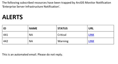

WhereMatters
This is a must-have feature for Monitor 2023. Currently, email notifications are not useful at all. Why do you have to click a link to see the alert? The email notifications at 10.8.1 were so much better, they told you at a glance, exactly what was the alert all about.

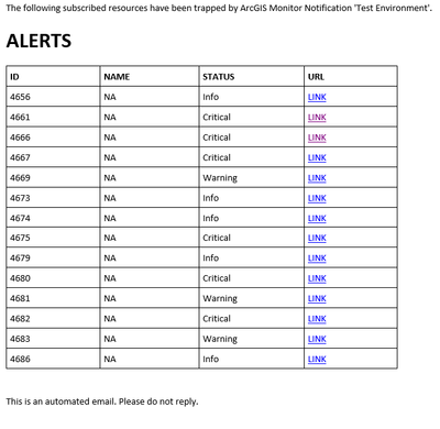

I take it the ID refers to the actively running metric? For instance the email sends as ID: 2, which in the list is labeled as Name: Process CPU Utilized - postgres.exe (%). It would be excellent if instead of NA in the email Name field it could insert the label Name of the metric...

We recently upgraded to 2023.1 version and the notification still does not show the name and appears as NA
Kindly look into it as its very critical to respond to production components and compared to test/dev components based on the email we receive.

We'd like to add to this request as well. We're happy to see the LINK take us directly to the issue (yay this is an improvement from the old monitor era) but overall this email is not a useful for administrators.
ID numbers and Name as NA is not helpful. Please consider implementing this update sooner than later.

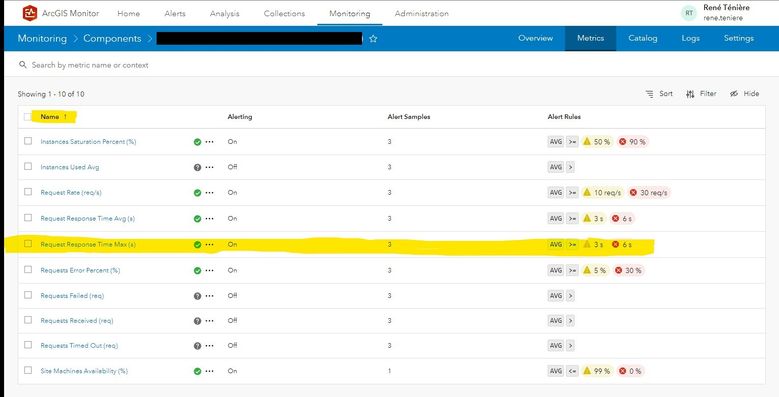

The 2023.x notification contains the following information:
The Email Subject Line – Collection Name
The following table is included in the email whereby NAME field references the Metric Name, only it says NA but as seen in the screenshot below it should state Request Response Time Max (s). STATUS field indicates the alert threshold, which was Warning, however, the ALERT RULE and ALERT VALUE should be listed as AVG >= and 3 s respectively.
ID
NAME
STATUS
URL
26
NA
Warning
LINK
At a minimum the new notification table with the existing information available (ID is useless and could be dropped) should be:
ID
COLLECTION NAME
METRIC NAME
STATUS
ALERT RULE
ALERT VALUE
URL
26
SERVERNAME: ArcGIS Server
Warning
AVG >=
3 s
LINK
As you can see, the notification email collects the information from the collection metrics whereby alerting is set to on:
