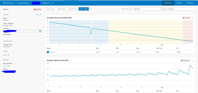

AmaiaMartinez
Hi there!
We are monitoring approx. 2000 components. We are experiencing the same issue... C drive is full again and again...
We cannot continue extending it, so we'd need you to provide how to do this manually (to free up disk space by dropping PostgreSQL older partitions in metrics_data table).
Additionally, we have found that suddenly there is a big peak on the disk space usage (see the pattern):
Thank you in advance!

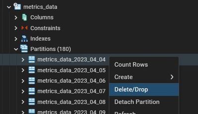

AndrewSakowicz
@AlexanderSchiestl please follow:
  1. back up your pg database, https://www.postgresql.org/docs/current/backup.html
  2. Drop old partitions in metrics_data table
