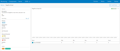

Hello, I have my ArcGIS Server machine as a host in ArcGIS Monitor. However, it is not returning any Pagefile Utilized metrics.
Other metrics like Memory Utilized or Memory Available are returning as expected. This issue also seems to be isolated to this host machine. The other 17 registered Host machines appear to be returning the metric.
Any ideas other than un-registering and re-registering?

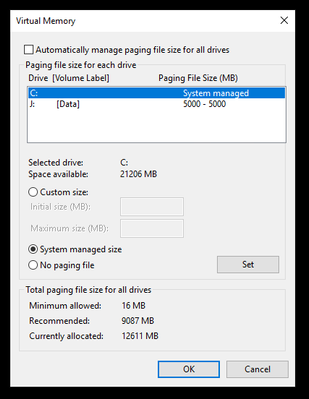

@Joel_Lopez Check if the pagefile is in use/activated for the server in question. You can do this by following the below:
1) Login into the server in question
2) Right click This PC >> Properties >> Advanced system settings >> Under performance click Settings >> Click on Advanced tab >> Click on Change >> Check if any drive has page file switched on.
This could be a way to check if the pagefile is actually in use. Other way could be by checking Performance Monitor to view if pagefile is getting consumed or no.

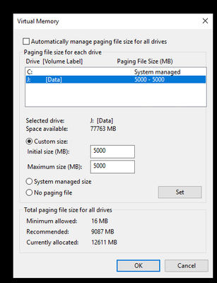

Thanks Shawn. Looks like this server is the only one that is not set to the option "Automatically manage paging file size for all drives".
Do you think checking that setting on will resolve the issue?
Shawn_NG

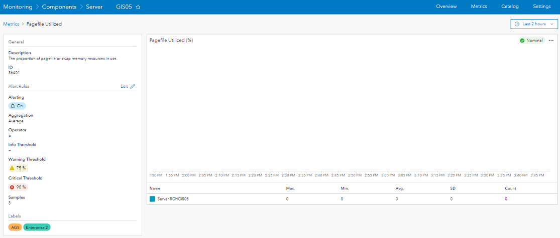

Hello @Joel_Lopez , Checking that setting should allow pagefile to be utilized but the monitor graph will only show variations if the pagefile gets utilized by the application.
Joel_Lopez
Thanks Shawn. I updated it to system managed and Monitor is now reading it. It seems to have expanded the pagefile size to 10GB but it hardly gets utilized. I assume that's a good thing. And there is plenty of available memory on the server.
