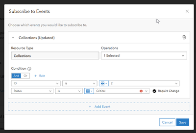

How to set up a custom notification on a Collection where the alert status is Critical.
I have defined the Collection I want an alert on and the status under the Condition section. However, I am still receiving alerts on Warnings for the Collection.

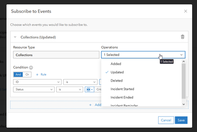

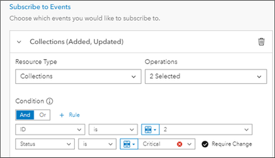

GeoJosh
Hello, which options do you have selected under "Operations"? I just tested this with the following configuration and it worked as expected. I triggered a warning alert and did not receive a notification. I then triggered a critical alert and received a notification.
