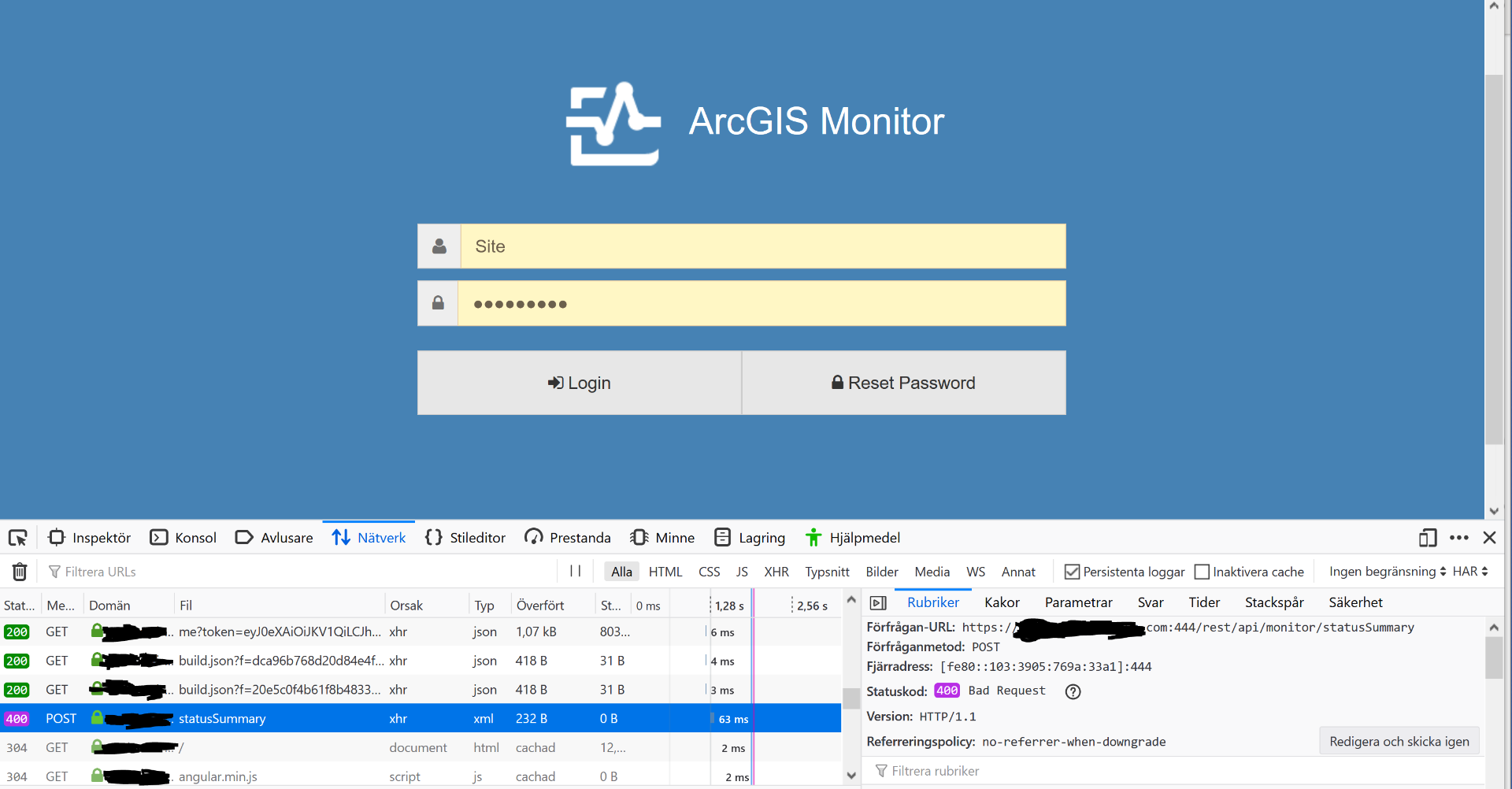

Hello,
I just installed ArcGIS Monitor locally on a DELL Precision 5530 CORE i9 laptop with W10 Pro 32 GB RAM.
ArcGIS Monitor Administrator seems to work fine, I can create Collections, Counters etc but I cannot log into the ArcGIS Monitor Server Application web UI: https://<mymachine_fqdn>:444...
At first it seems ok after entering credentials (Site/mypwd) and hitting enter, the screen flickers and it kind of looks like the login succeedes, but I end up back on the login page... Looking in the Network trace I get a 'Bad Request' for URL: https://<mymachine_fqdn>:444/rest/api/monitor/statusSummary
Any Ideas?!
Rgds,
/Erik

The problem is the current version of MongoDB is not compatible.  Please check the documentation and download the supported version of MongoDB.

We are having the exact same issue here. I installed ArcGIS Monitor 10.7.1 last week but cannot log in to the web application with the same "400 Bad Request" error https://...../rest/api/monitor/statusSummary

What version of MongoDB are you running with ArcGIS Monitor? I have seen this issue before when an unsupported version of MongoDB is used, most notably with 4.2x. Please confirm the MongoDB version, and if necessary install with a supported version of MongoDB (4.0 or below).
ArcGIS Monitor system requirements—Installation Guides | ArcGIS Enterprise

Hi Joshua, yes Im using 4.2.x. Will re install "everything" and keep you posted!
