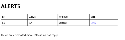

We are seeing the following when an alert email is triggered (e.g. Portal Index):
What is the name "N/A"? Where does it pull this Name value from? Unfortunately these alerts are pretty unhelpful in current state if it doesn't list out what the alert source was and which resource/components were affected.

Hi Eric,
"Name" is inherited from the name property of the resource that triggered the alert. Alert resources do not have a name property, which is why "NA" is shown. If you were to set up a custom alert on a component, collection, etc., "Name" would show the name of that resource.
