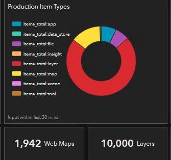

1. We have more than 10000 layers on the portal, and on the dashboard, the value is capping at 10000 only.      Below is the screenshot for the same:-

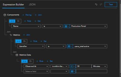

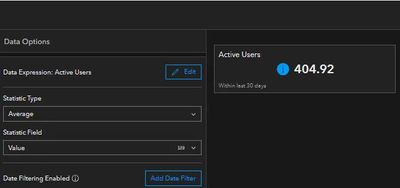

2. We have identified that sometimes the value of Active users and Total users is shown in decimals. I am attaching the screenshot of the data expression we have used.

1. Our team has opened an enhancement in our development backlog to address returning all of the layers in portal
2. The value of Active users and Total users is shown as a decimal because the statistic type is set to average for the indicator in your last screen shot. A better statistic type for the indicator would be max.
