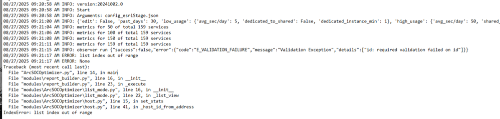

I recently did a clean install of ArcGIS Monitor 2025.0.1 (previoulsy running v 2023.3.1) and have not been successful getting ArcSOC Optimizer to run.   Seeing the errors below.  @AndrewSakowicz  got any advise to resolve these errors?  Thank you for your continued support of this tool.  I'm not sure what I would do without it!  ...contemplate a new career, perhaps. Kidding, kind of 🙂

@MarieCline_Delgado I've had the same issue since I upgraded. I miss that tool so much! Hoping to hear of a solution.
