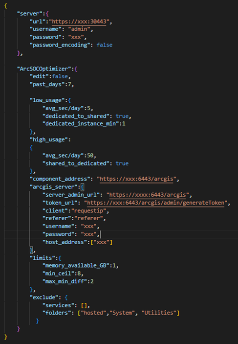

ArcSOCOptimizer.exe -f SampleConfig.json
SampleConfig.json
edit:false/true
False executes in read only and produces a list of recommendation.  Start with False, review and validate the results.  Once validated, execute true.
past_days:number
Number of past days to be analyzed to determine low and high usage.
The recommendations are based on historical data.  You may choose to increase the 7 day default.
avg_sec/day:float
Average number of seconds per day a service is used throughout all past_days.  For example, if during the business hours service is used 10 seconds per day and 0 seconds during the weekend, the avg_sec/day=avg (10,10,10,10,10,0,0).  This can be evaluate using the combination req/s and response time, see below
shared_to_dedicated: true/false
Allows or disallows low usage services to be moved from dedicated to shared.
dedicated_to_shared: true/false
Allows or disallows high usage services to be moved from shared to dedicated.
host_address:array
Each arcgis server machine should be registered with ArcGIS Monitor as a host component.  This parameter takes a list of hosts (in quotes), with the names exactly as the Address of registered host, see below.

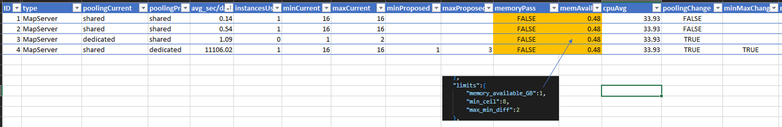

For example, in the following use case we have the following 4 services:
  1. ID 1 and ID 2 have a low usage (<5s) and already recommended shared pool.  Therefore, there is no change.
  2. ID 3 has a low usage (<5s), but dedicated pool. Therefore, pool change from dedicated to shared is recommended.
  3. ID 4 has a high usage and shared pool.  Therefore, pool change to dedicated and min/max instances are recommended

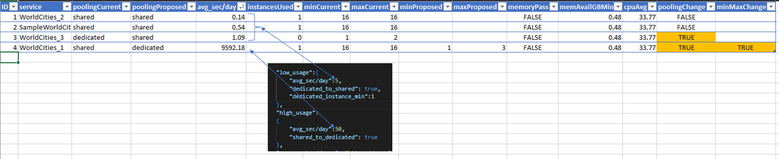

edit=true
Once you validate the edit=false recommendation, test executing edit=true manullay.  This mode will make changes to instances and pooling and restart services.  If satisfied, user could schedule this as a daily job, using windows scheduled task.

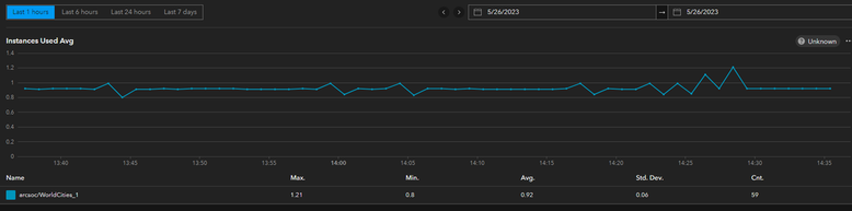

Note, the minProposed is calculated as the ceiling of Instances Used Avg.  In the case below, the ceiling of 1.21 is equal 2.

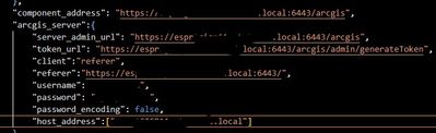

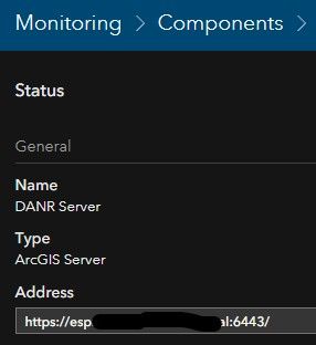

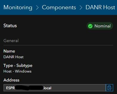

@AndrewSakowicz No matter what url I try I get the same alternating errors. Nothing has changed in the address from my upgrade to 2024.0.1.
Craig_Lunde
@AndrewSakowicz any suggestions?
AndrewSakowicz
@Craig_Lunde , per doc,
in your case, it appears there is a difference:
...local:6443/ - component address in ArcGIS Monitor
...local:6443/arcgis in the config file (change to as above: ...local:6443/)
I hope it helps.
Thanks,
Andrew
Craig_Lunde
@AndrewSakowicz Thanks! I also had to switch username/password from server to portal.

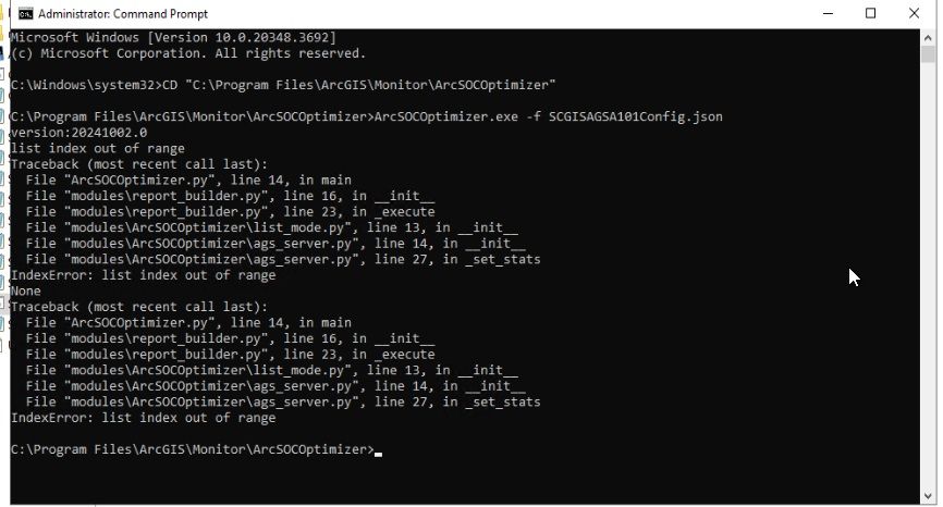

JoeGuziStarkCountyOH
Greetings @AndrewSakowicz ,
That is correct. When I upgraded to AGM version 2024.1.1+704, the ArcSOC Optimizer Stopped working. Below is the error. I just figured I would check in since you mentioned refactoring the code on 4/28/25, and it appears that the item has not been updated since 10/2/24. Please let me know if there is anything else I can do to help. Thank you for everything and have a delightful day.
