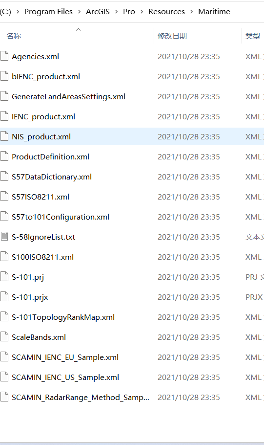

As you said ,The workspace xml  is for the ArcMap extension, because I can't  find NAUTICAL_ENC_TEMPLATE_GX_EXTCLSID.xml in my folder.
When I try to use the workspace xml with your provided,it is OK!thanks!

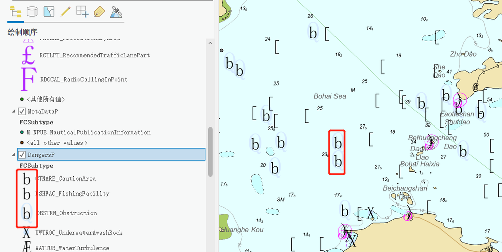

next step ,I refresh the symbol ,A new problem  appeared.
1.how can I display the correct symbol ?
2.Where can I find the file:NAUTICAL_ENC_TEMPLATE_GX_EXTCLSID.xml ?Install it in separate package?
CraigTGreene
It looks like you're missing some fonts. I thought since you had ArcMap Maritime installed, you would have the necessary fonts. I have attached the nautical fonts. You need to copy them to your Windows\Fonts directory.

Regarding the ArcGIS Pro ENC geodatabase workspace xml, it is installed with the maritime 'product files', which you have access to through MyEsri. Here is a help topic on how to install the product files.
https://pro.arcgis.com/en/pro-app/latest/help/production/maritime/download-and-install-product-files...
When installing these product files, I strongly recommend you install them to
C:\Program Files\ArcGIS\Pro\Resources\Maritime
This is where all the other resource files are installed, so it makes them easier to find if you install them there.

Thanks again! When I used the fonts,I've successfully display  S-57 with arcgis pro.
