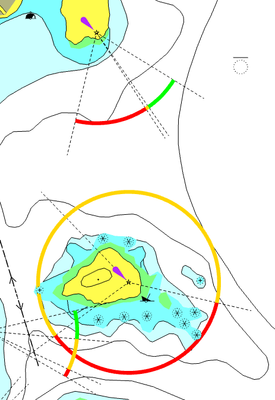

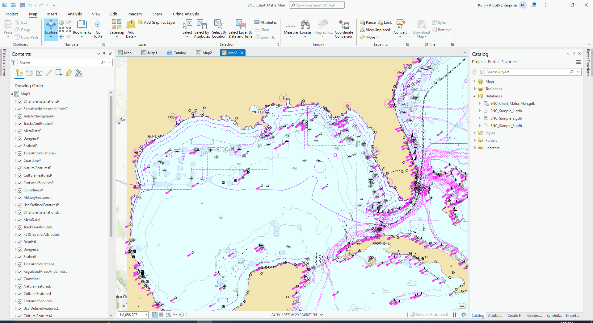

I am trying to import the S-57 cells to the Maritime Geodatabase and getting a symbology as shown below.
I am not the getting the ring symbology as it is shown in the below image.

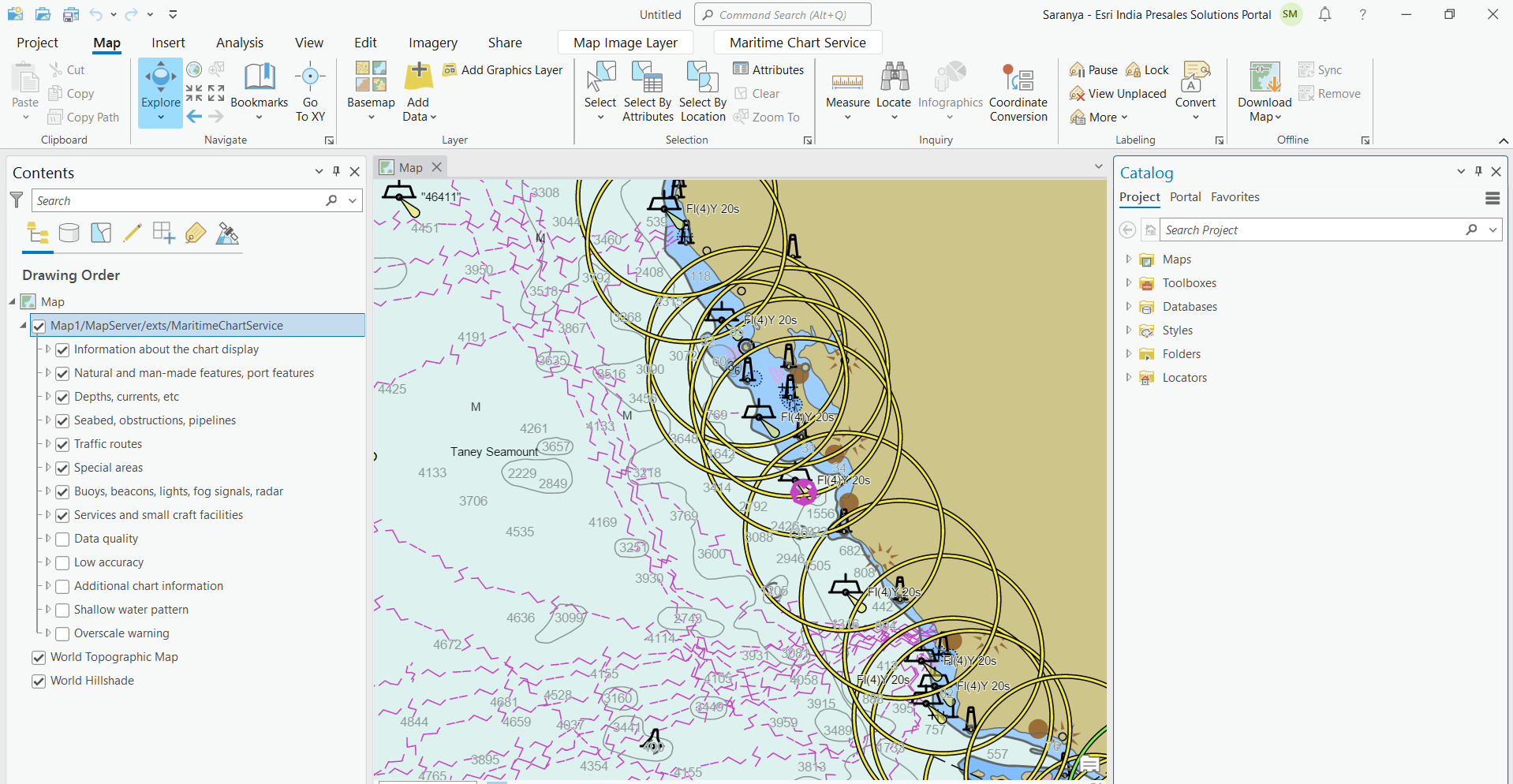

I am getting this ring symbology while only using the ArcGIS Maritime Server extension and not in ArcGIS Pro. Can you please let me know that what's the reason for not getting the ring symbology in the ArcGIS Pro Maritime Desktop Extension.

The light sectors (rings) are rendered on the fly directly from the S-57 data in the maritime chart service. However, in the geodatabase, since the actual light sector features are point geometries, additional line/arc geometries need to be generated to represent light sectors.
In the next release of ArcGIS Pro, there will be a new geoprocessing tool - Generate Light Sectors, that creates these features in the geodatabase.
