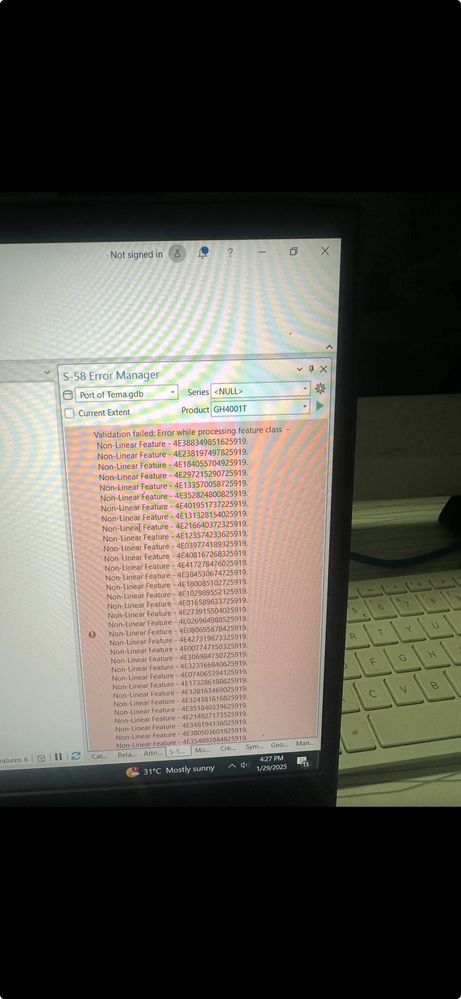

Features Cannot be created or Edited
440
01-29-2025 07:35 AM
GabrielAweya
I cant create any fatures or edit existng ones as it gives the error provided in the image belowIMG_1592D8B01B49-1.jpeg
CraigTGreene
Non-linear feature error typically points to multipart features, which are not allowed in S-57.  You will need to explode or otherwise convert your multipart features to single part.
pocalipse
Hi,
We had the same issue last week and our problem was a couple of empty and null geometries in a polygon. It is however a bit tricky finding these if you are working on a versioned enterprise geodatabase. If you are working on a file geodatabase you are able to find a couple of geoprocesses that may help you find such geometries.
