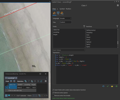

Is there a similar workflow or available style file for the above? i did have a couple expressions in ArcMap to carry this out but seems a bit tricky to convert them across to pro,
Ideally, taking one collumn with the depth value for example 11.8 and labelling that as per below:
I thought with a subscript tag, i also thought there might be an easier way to achieve this,

JohannesLindner
MVP Alum
Something like this?
// label value
var x = 11.8643
// number of subscripted digits
var digits = 1
// integer part
var x_int = Floor(x)
// decimal part
var x_dec = (x - x_int) * Pow(10, digits)
x_dec = Round(x_dec, 0)
// put it all together
return x_int + '<sub>' + x_dec + '</sub>'

KeiranBray
Hey Johannes, that worked!
Thanks heaps exactly what i was after:
