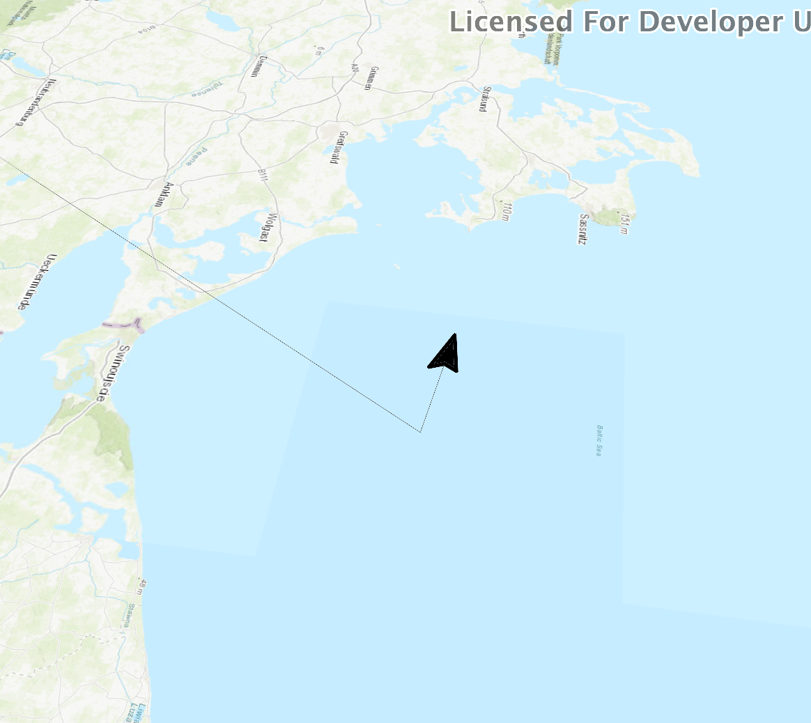

  • Add graphics to your graphics overlay, and they will be symbolized with the custom symbol. In the below example, a simple black line with an arrow at the end of the line was created in Pro and consumed in ArcGIS Runtime.

I modified the project to switch out MapView to SceneView, and here are my results:
You can't yet scale the arrow/line on the client side, although you could change it in Pro, and have you style file contain several different sizes. We are hoping to start supporting client side modification (and creation) of these types of complex symbols soon in ArcGIS Runtime.
