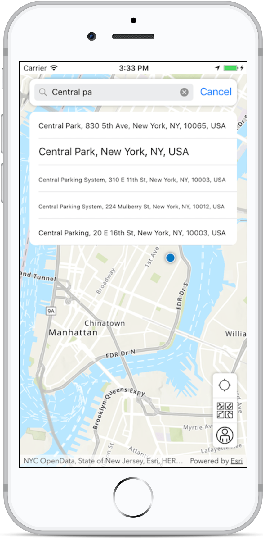

The Runtime SDK does a lot of work behind the scenes to make it as simple as possible for you to write great, interactive mapping apps with fast, smooth user interfaces.
Getting out of the way
Key to that is making sure that when you ask Runtime to do something asynchronous (query some features, autocomplete an address, load a service definition etc.), that it gets off the thread you called from as quickly as possible and does its work on another thread. Runtime does this really well and you should never see it get in your way while it's doing something.
