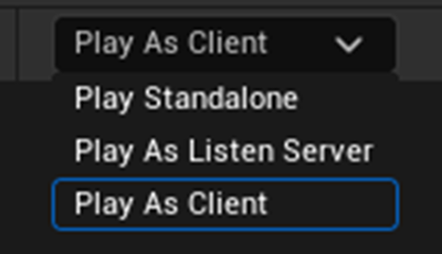

Now, the attached videos demonstrate my problem I am still facing. When in client mode, the vehicle falls through the map. When running in one of the other modes, the mesh colliders work. However, I need this to run in a multiplayer application that requires "client" net mode. (For reference, the ArcGIS Camera pawn is above the vehicle pointing down at the map)
Net-Mode Options (Editor Preferences):
