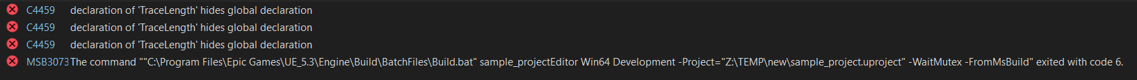

and error list:

AShahbaz
This should now be resolved in the main branch as well. So you can simply pull the main branch or get a new copy of the Samples repo. Let us know if you are still having issues with this.
LuigiMussardo
It finally works! Thank you all for your support!
