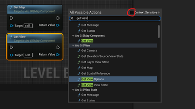

If you can't find a specific Blueprint node/function, you can try to uncheck the "Context Sensitive" option in the Context Menu. You should now be able to find the "Get View" node for example:
Ref: https://developers.arcgis.com/unreal-engine/maps/tutorials/display-a-map-bp/#set-up-a-basemap-and-se...
