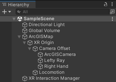

I was able to get this working on my Oculus Quest 2 goggles -- including joystick continuous movement -- by following essentially what @GordonCooke posted above. This matched what Esri provided through the support channel. Pasting a snip of my hierarchy here...
... Nicely, I did not lose anything I previously had working in my scene, namely snap turn and teleport.

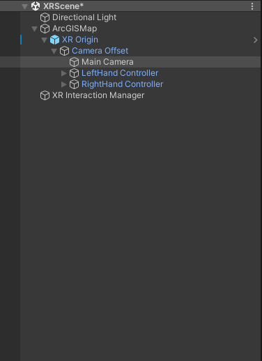

I was able to get most of this working by dragging the "ArcGIS Map" underneath my "XR Origin". With this setup I can:
  • look around in my scene by turning my head
  • "snap rotate" the scene using controller joystick
  • teleport in the scene using controller button
Continuous movement is still _not_ working as expected.
FWIW there's another recent post which suggested that dragging the ArcGIS Camera under the XR Rig worked (for Steam VR/Hive).
And so... I'm not sure I have exactly what I need, but it is doing the trick for now.

I started with a XR rig, then brought in the ArcGIS package and added a local map. The XR Rig needs to be a child of the ArcGISMap object. (If I understand correctly, the map has coordinates that are geo referenced- ie 0,0,0 is Null Island out i the ocean, so if the XR Rig is at 0,0,0 then it is other side of the planet from the map- thousands of kms away)
In the open XR Rig- I put the ArcGIS camera where the usual camera goes (under the camera offset) and deleted the normal Main Camera object. So you have the Arc GIS Camera, Right and Left controllers.
I also had to change the ArcGIS camera near clipping plane in order to see the controllers. The default is 0.5 meters so the controllers are close enough to be clipped unless you stretch out your arm.) But I had to turn off (uncheck) Update Clipping planes so it didnt reset to default of 0.5. I dont know if there is a way to change the clipping planes (there must be) but turning the update off will be a problem if you have an use case that changes altitude (like ground to orbit) but should be ok if you have a relatively fixed altitude (walking on ground, flying at an elevation)
(I used the XR Interaction toolkit) Snap turns work. I didnt try teleport. Continuous move provider (action based) works- but the speed needs to be enough that you would notice it (100m off the ground and a speed of 1 moves the ground so slow you barely notice it, but 10 was much better.)

Thanks for posting this. Your hierarchy aligns with what Esri recommended to me via support...
... then set up the ArcGIS Camera component per the doc.

coryeicher
