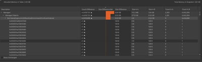

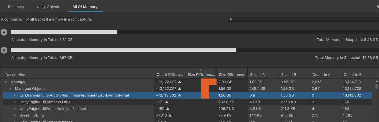

I have attached a memory snapshot where I compared the memory usage after running 1 hour just rendering the ArcGIS map and it is quite noticeable that an additional 13+ million new objects for ArcGISRuntimeEnvironmentErrorEventInternal is created during this time and this is the cause of the leak. I have no issues rendering the map at all and I receive no other errors.

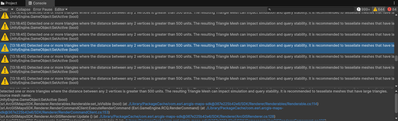

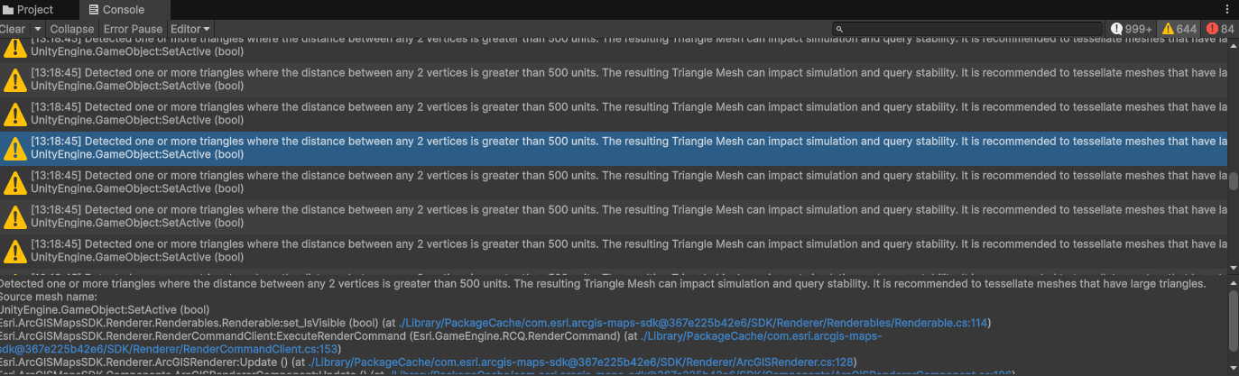

I do however receive the following warnings:

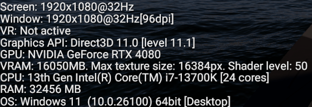

System specs:
ArcGIS Unity SDK 1.7 (have also tried to downgrade to 1.6 that we use in 2023.1 and the memory leak is still present)

I'm having the exact same issue and for this reason the app (both macOS and Windows builds) is crashing after a few hours of use (out of RAM). The value you see in the screenshot goes up really fast, allocating a lot of GB over time.
