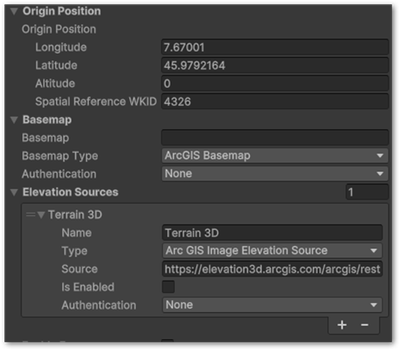

This is what the Inspector looks like with ArcGISMap GameObject selected.
No basemap and elevation source is disabled.

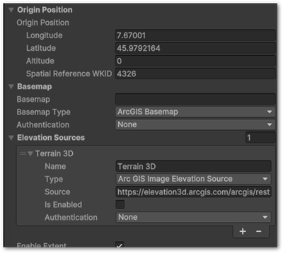

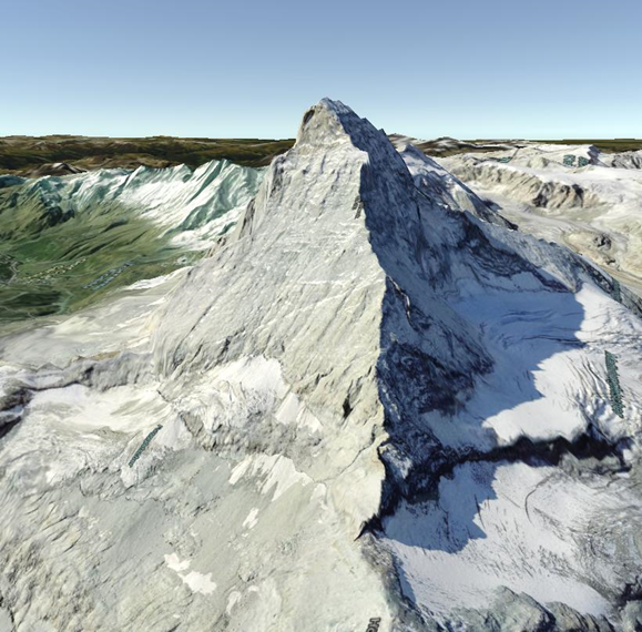

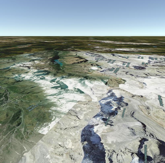

After running the C# script everything’s fine. Most importantly basemap and elevation are obviously applied in the Game View window.

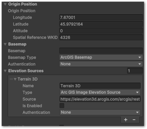

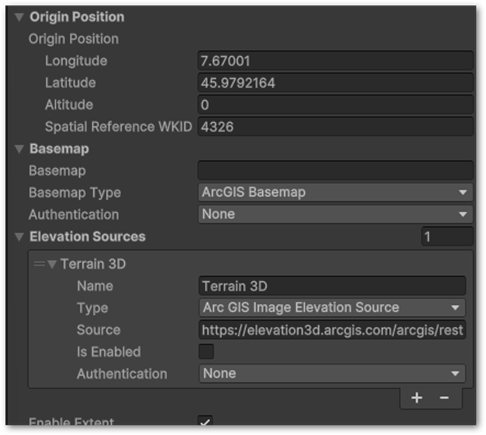

But the Component isn’t updated at all (please see screenshot).
However, if the elevation is disabled in the C# script like so
arcGISImageElevationSource.IsEnabled = false;
it shows in the scene when the script is run again. So the functionality seems to be fine but the updated values are not shown in the Component itself.
