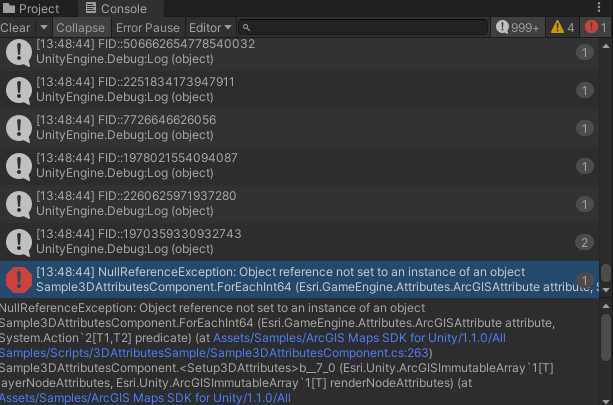

(I first tried to debug output of the FID.
I can output it, but it seems to be different from the value output in the HitTestSample scene.)

                Int64 element = *((Int64*)intPtr); // Rises NullReferenceException: Object reference not set to an instance of an object
                predicate(element, i);
                intPtr += sizeof(Int64);
runtime console:
