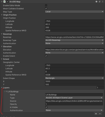

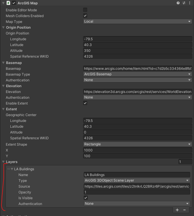

The Layer I am trying to change is added in-editor using the component interface and I am able to change these settings while the game is running and have them reflect on the map. However, when I try to reference the layer in code via the API, nothing changes on the map.
I am referencing the layer using ArcGISMapComponent.View.Map.Layers.At(index)
The layer shows up here and has all of it's data included based on what I set in the editor.

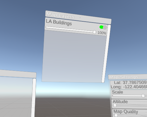

Just as a sanity check, here's some snippets
// Populating the layer list seen in picture
for (ulong i = 0; i < layers.GetSize(); i++)
        var l = layers.At(i);
        var item = Instantiate<LayerListItem>(_listItemPrefab);
        item.transform.SetParent(_content, false);
        item.Layer = l;
// UI Events
void onToggle(bool on)
    _layer.IsVisible = on;
void onAlphaChanged(float a)
    _layer.Opacity = a;
    updateAlpha();
